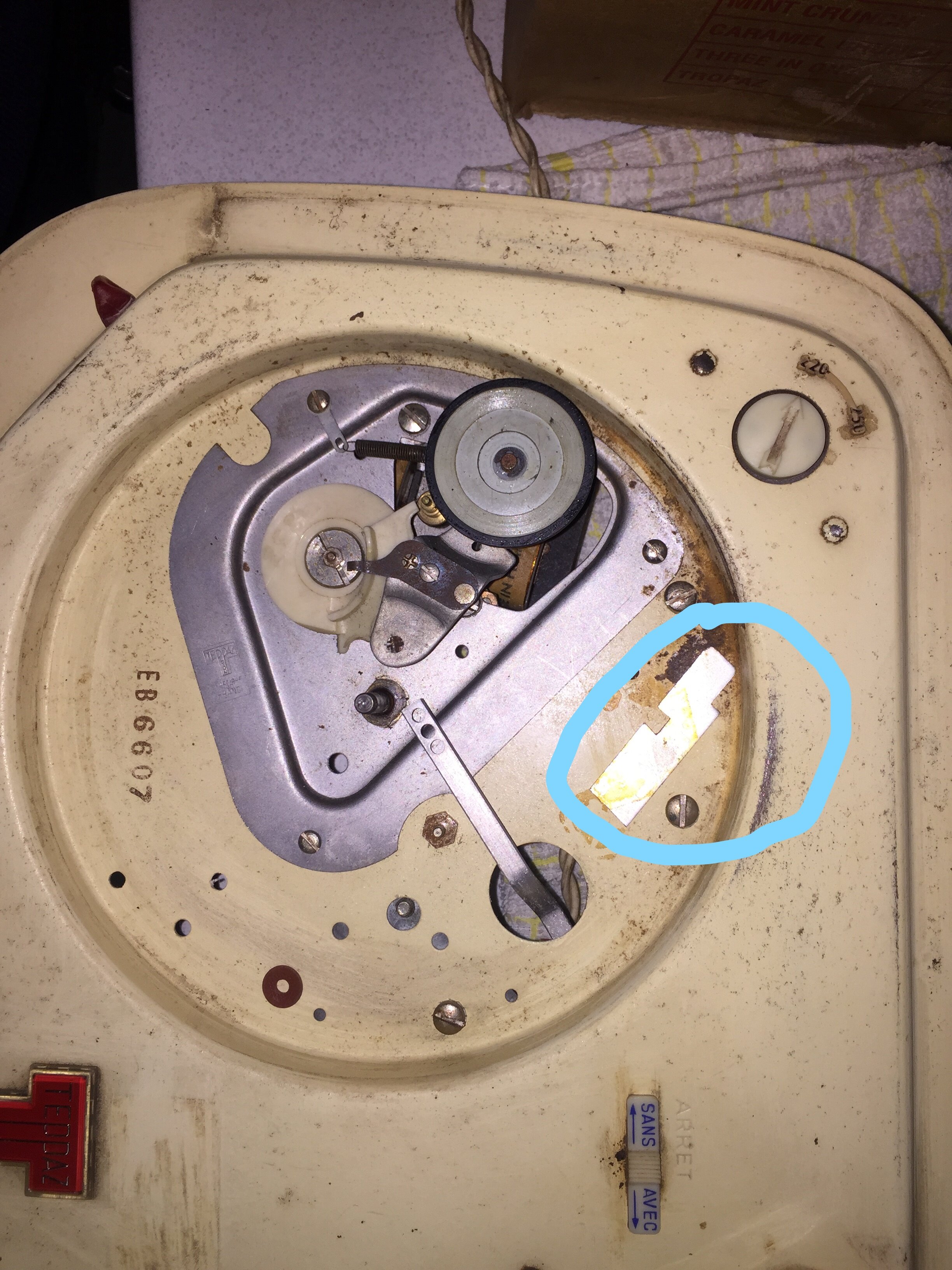

Thank you so much for all the responses, it really is nice to be part of a forum that can actually help. I will most certainly change the cartridge. I have another question, when i disassembled the unit I found this piece of metal stuck with sellotape. I am not sure what it is used for. The piece is completely loose. Have no idea where it fits in. I thought maybe it is used to change the voltage switch on front?

I don’t see this white piece on this picture
but one metal piece seems not in place ?
it is usefull and necessary the good function of the stop mecanism

Hi Radiolo,
Thanks for the pic, i will have to make a plan and get that piece of clip so it operates correctly

Are you able to send me dimensions of that return metal stopper i am missing. I am sure I can have one made to fit
i don’t have this teppaz at home
but you can copy de dimensions on the picture and there is a oval hole to fit te piece in the good position
