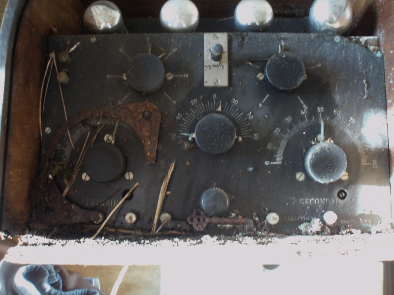

Hello, I’ve just registered with the forum, I cannot speak French, my appologies.
Does anyone recognize this, found in the UK a few days ago:
Many thanks.

I suppose your equipement is not a radio one . perhaps a wire line telephone or telegraph repetitor ? but I am not at all sure !
But somebody beyond us could have another opinion and better idea ![]()
wait please .
Good morning
This équipement looks like a very old SFR receiver
Thankyou Claude for the reply, I have made a schematic from the physical appearence, L10 in the scematic looks like a regeneration control.
There are 5 band ranges for the grid circuit and the anode circuit of the RF amplifier, the grid circuit has 3 extra ranges for bandspread.
The switch S3 enables it to be used as 4 valve, 3 valve or a 2 valve.

sorry , on your first photo I had not seen the four tubes up of the photo !!! ![]()
So , it changes completely my opinion ! and surely it is a very old radio receiver as said by F6CER ! ![]()

SFR is a very old company , manufacturer of radio sets in the 1920's . which became Radiola later
Could be a radio set similar this one
http://www.radiomuseum.org/r/sfr_lampes_sg5.html

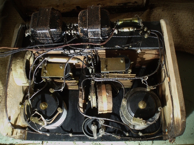

Thaks for that Claude, here are some more photo's, they show one of the tuning capacitors, the brass shaft extends to the front panel for slow motion/finetuning control.
Lawrence.
If you clean the front panel , could be seen some more info , perhaps a brand name or logo ???
It seems something is written hidden by the key bottom of the panel
I've removed the dust from the front panel the only identification is....RI 221.
The grid resistor, and the coupling and decoupling capacitors have the name ....Veritable Alter.
There are no other identification marks, no sign of any identification plate or label etc ever being attatched.
The HT terminals are marked 80 volts, the filament terminals are marked 4 volts.
I'm intrigued by the slow motion/ fine tuning adjustment, no knob, just a screwdriver, maybe to monitor CW transmissions?
The receiver is a mystery.
Lawrence.
Hi Lawrence,
I don’t know the brand of this receiver either. But I’m sure someone will tell you soon.
I can only tell you that the split pin of the fine tuning is made for plugging a long ebonite rod (lost as always !)
This was supposed to avoid the “hand effect” when tuning the capacitor.
Something similar to the Pericaud below.
Cheers for now
Jean-Luc

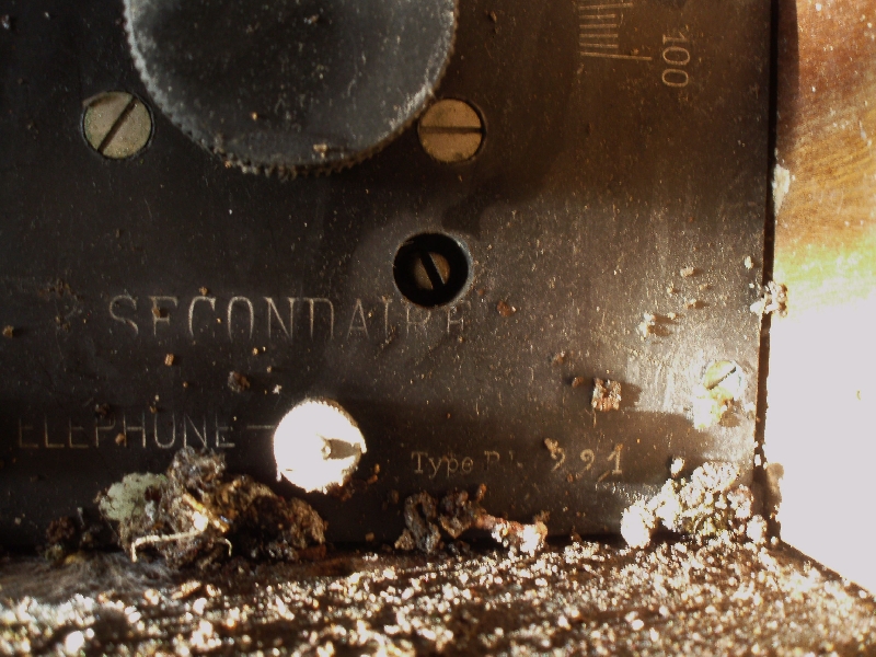

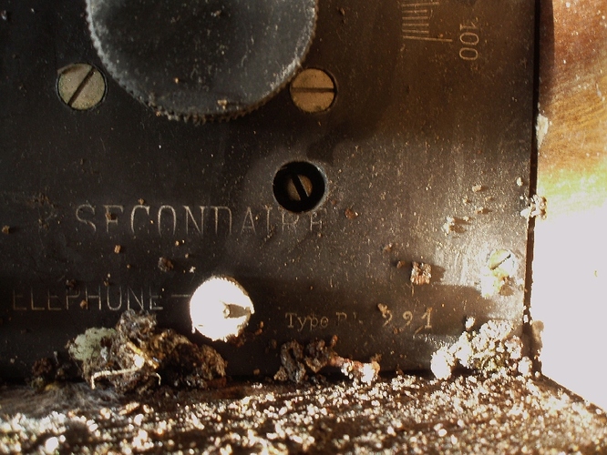

Je l'ai regardé le numéro de type avec une lumière LED ..... il est de type RK et non type RI.
Des idées?
Laurent.
