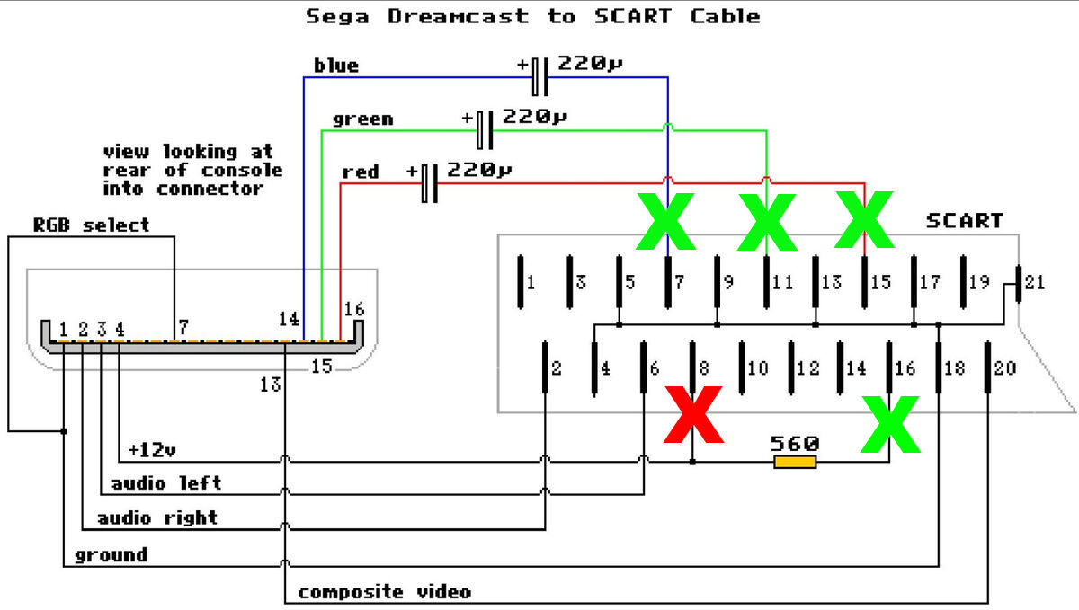

Coupez selon la croix rouge pour une meilleure qualité (RVB) sinon essayez en FBAS selon les croix vertes tout en testant les 2 positions AV de la télécommande en ayant rebranché la pin 8.
Cut according to the red cross for better quality (RVB) otherwise try in FBAS according to the green crosses while testing the 2 AV positions of the remote control having reconnected pin 8

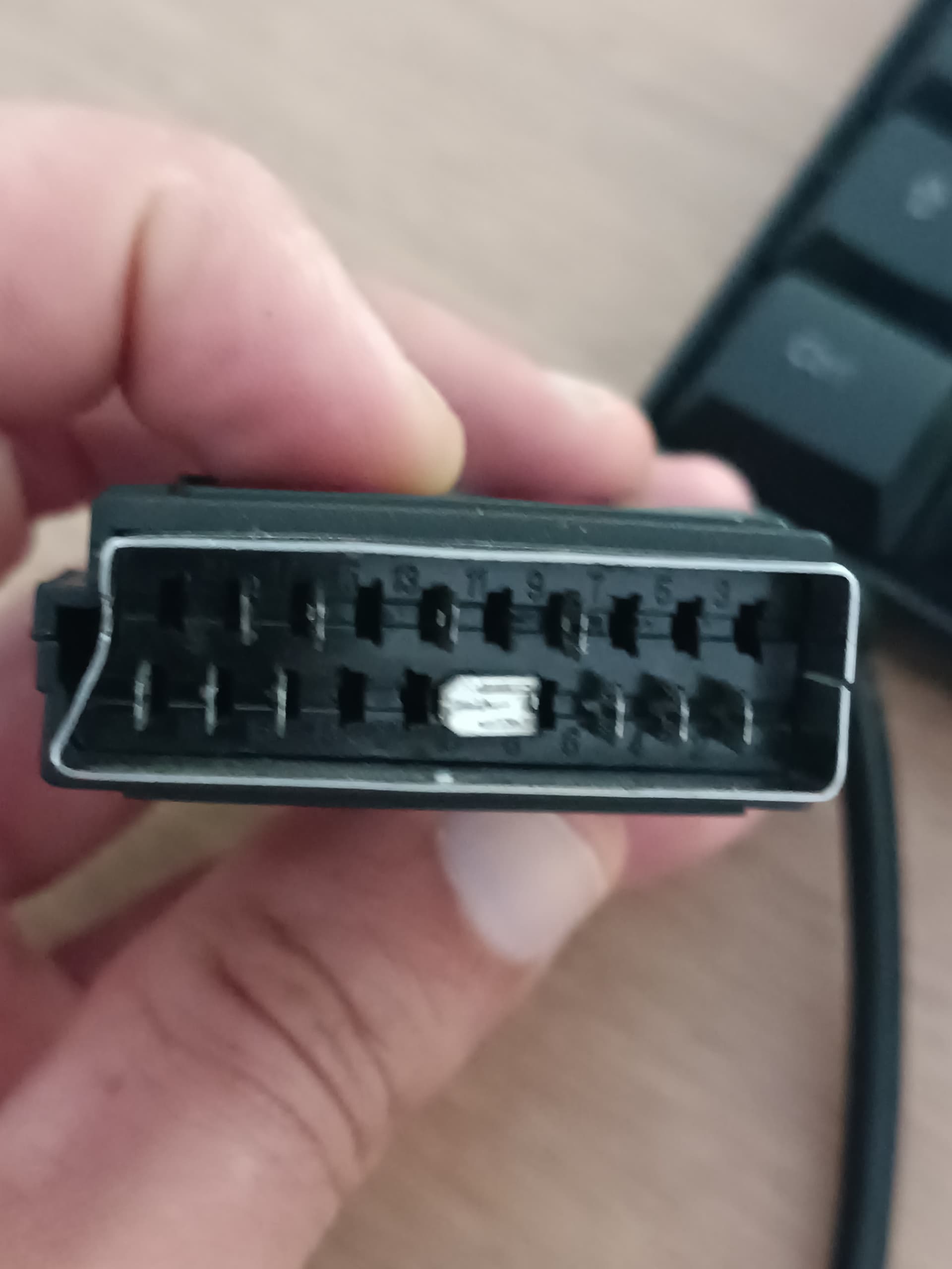

I just bended the pin inside the scart connector without removing

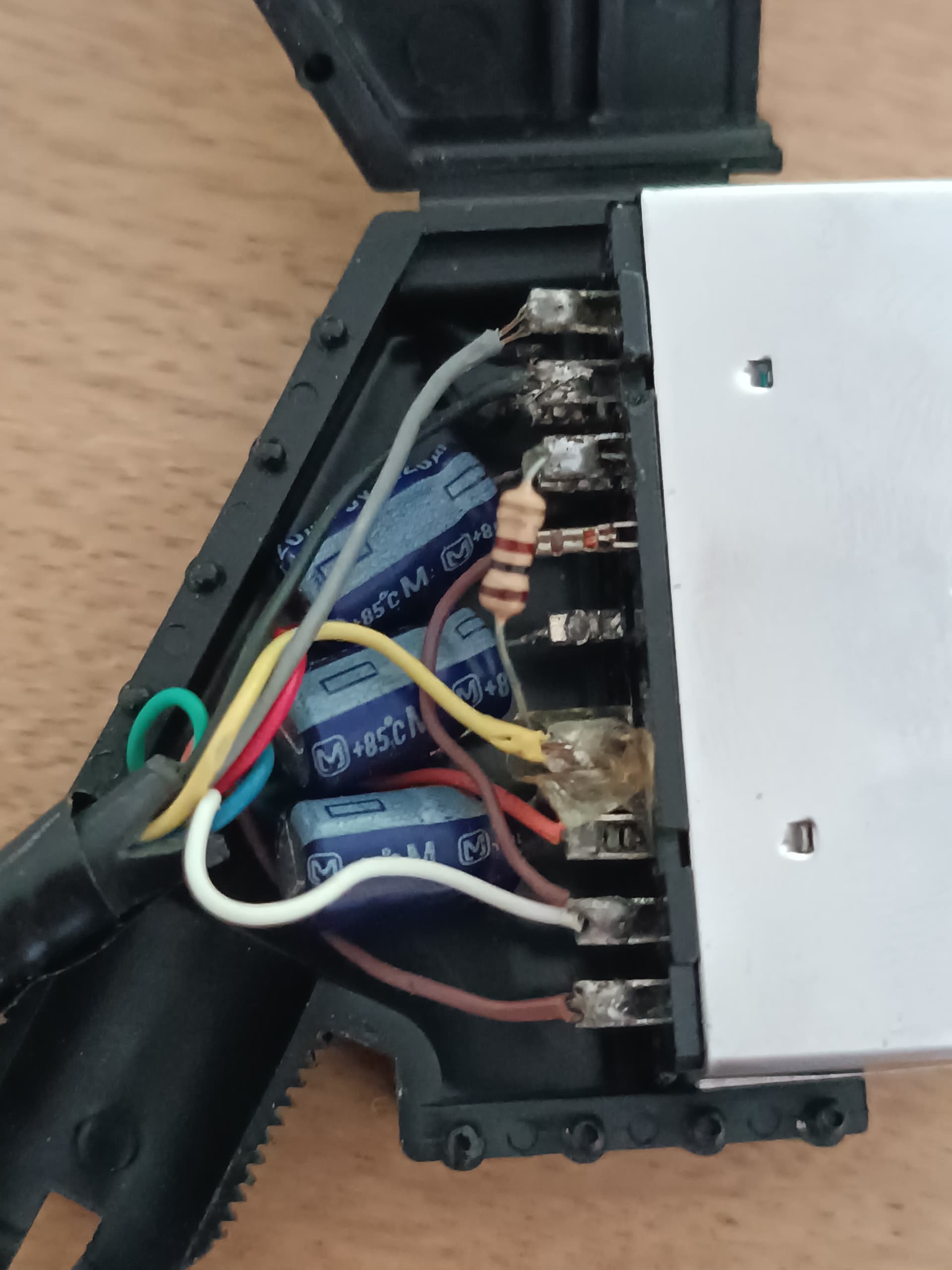

I have 2 different scart cable for the same console and unfortunately pinout on the scart is slightly different.
need to open the scart cable to be sure that pin 8 in that socket is +12

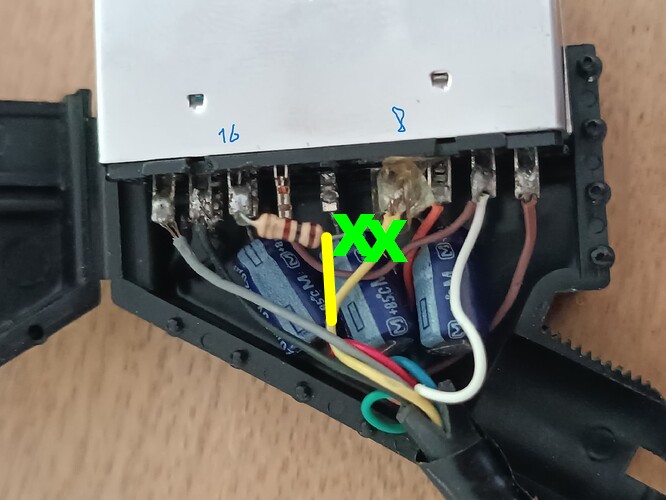

I need to cut the yellow cable i think right?
Je dois couper le câble jaune, je pense que c’est vrai ?
Il faut que la résistance et le fil jaune soient isolés de la pin 8 mais le fil jaune doit relier la résistance comme indiqué sur la photo.
The resistor and the yellow wire must be isolated from pin 8 but the yellow wire must connect the resistor as shown in the photo.

Il serait peut-être judicieux de tester la commutation lente soit juste les pin 8 et 20 (votre console a l’air de générer de la FBAS). Ce serait plus raisonnable sur un vieux TV. Essayez déjà ce que vous faites sinon ensuite câblez suivant les croix vertes en recâblant la pin 8.

It might be a good idea to test slow switching, just pins 8 and 20 (your console seems to be generating FBAS). It would be more reasonable on an old TV. Try already what you are doing otherwise then wire following the green crosses by rewiring pin 8.

Why did you bend pin 8 ?
It’s precisely this pin which should carry 12V to put the TV in « external » mode.
Can you check if your video source really delivers 12V on this pin ?
If not you can use an external 12V power supply or battery to force the TV in external mode.
If the voltage on pin 8 is less than 10V, this voltage may be insufficient to put the TV in external mode.

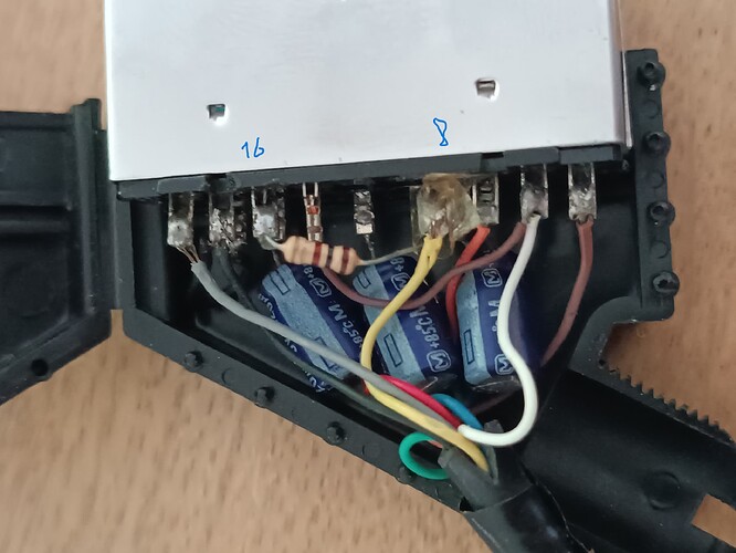

If you remove the 560 ohm resistor you should see composite video on the screen, assuming the slow switching is working properly. There is no need to disconnect the RGB signals.

It’s normal to have 12V on pin 16 when the cable is not connected (no divider bridge with the internal 75 ohms of the TV).
But the TV does not seem to switch to « external » with 12V on pin 8, so you should see no picture (black screen) when pin 16 is not connected (no need to disconnect the RGB cables, just disconnect the 560 ohms resistor).
