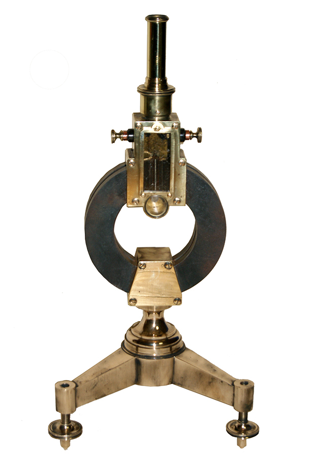

Combien de points celui ci ? :slightly_smiling_face:
:wink: Daniel
