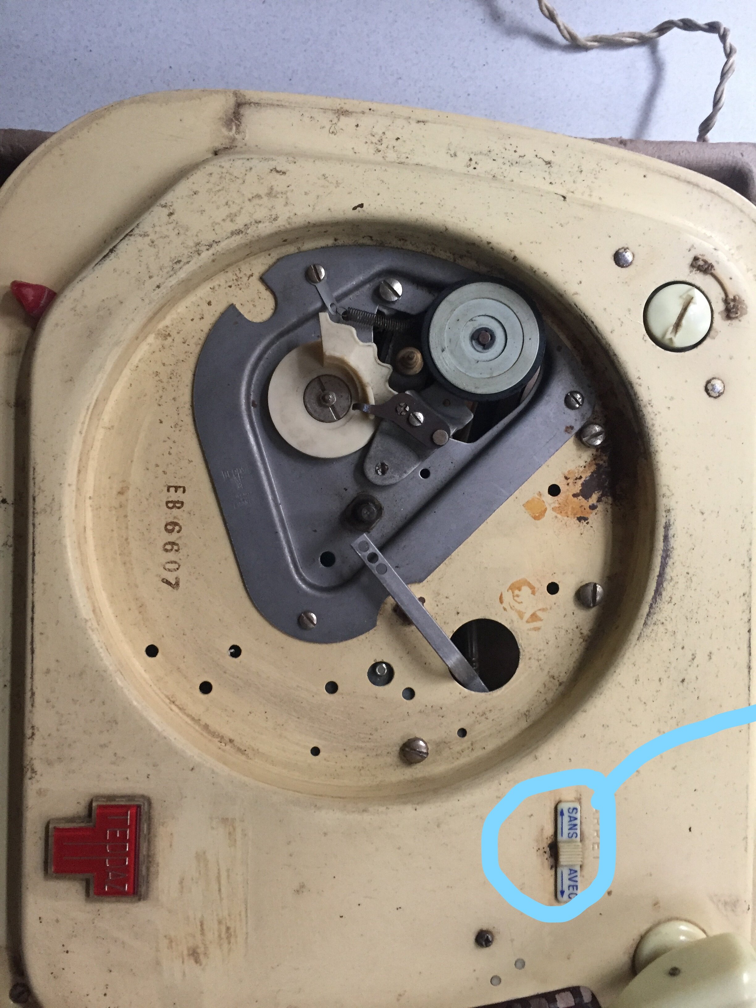

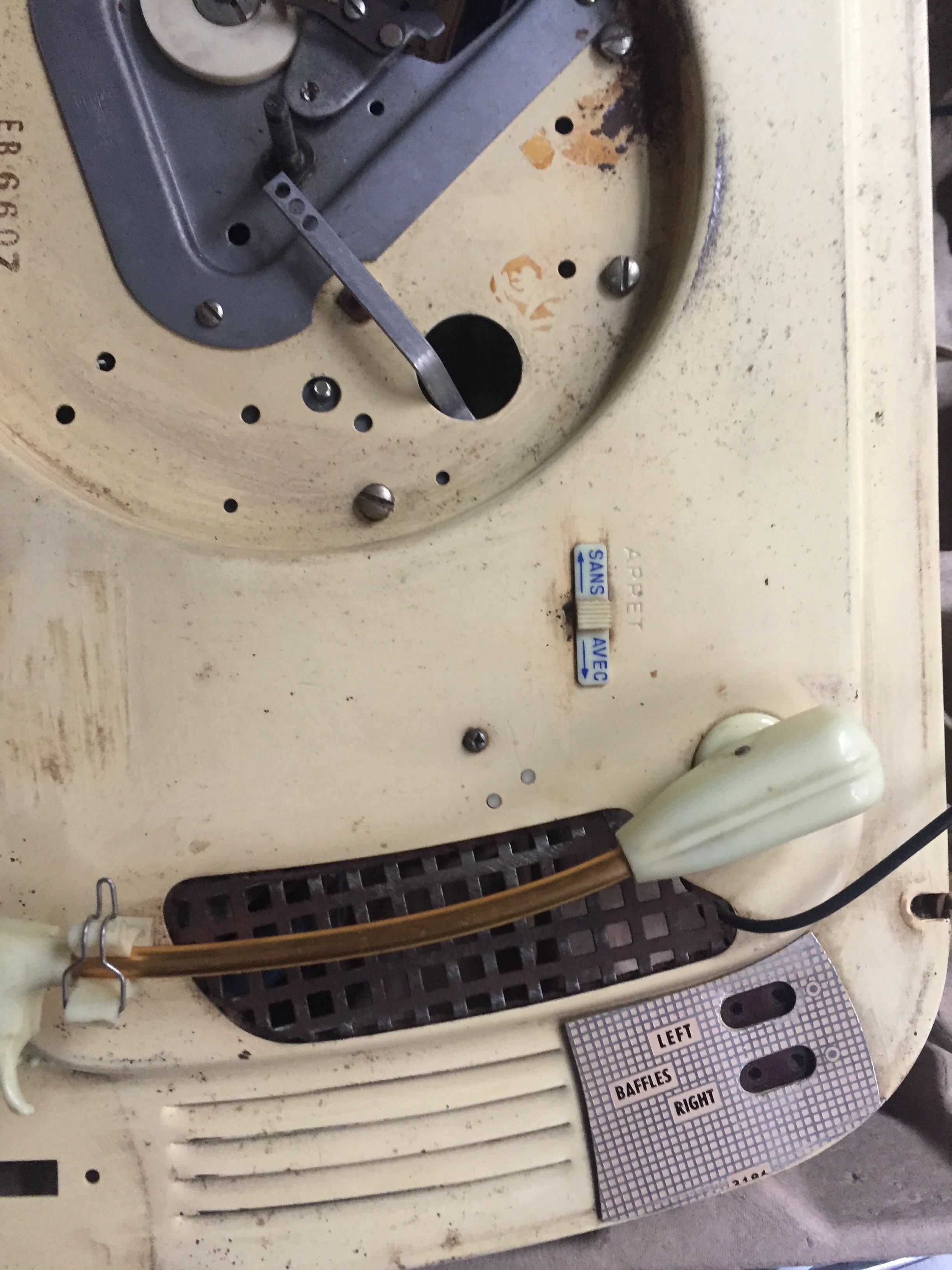

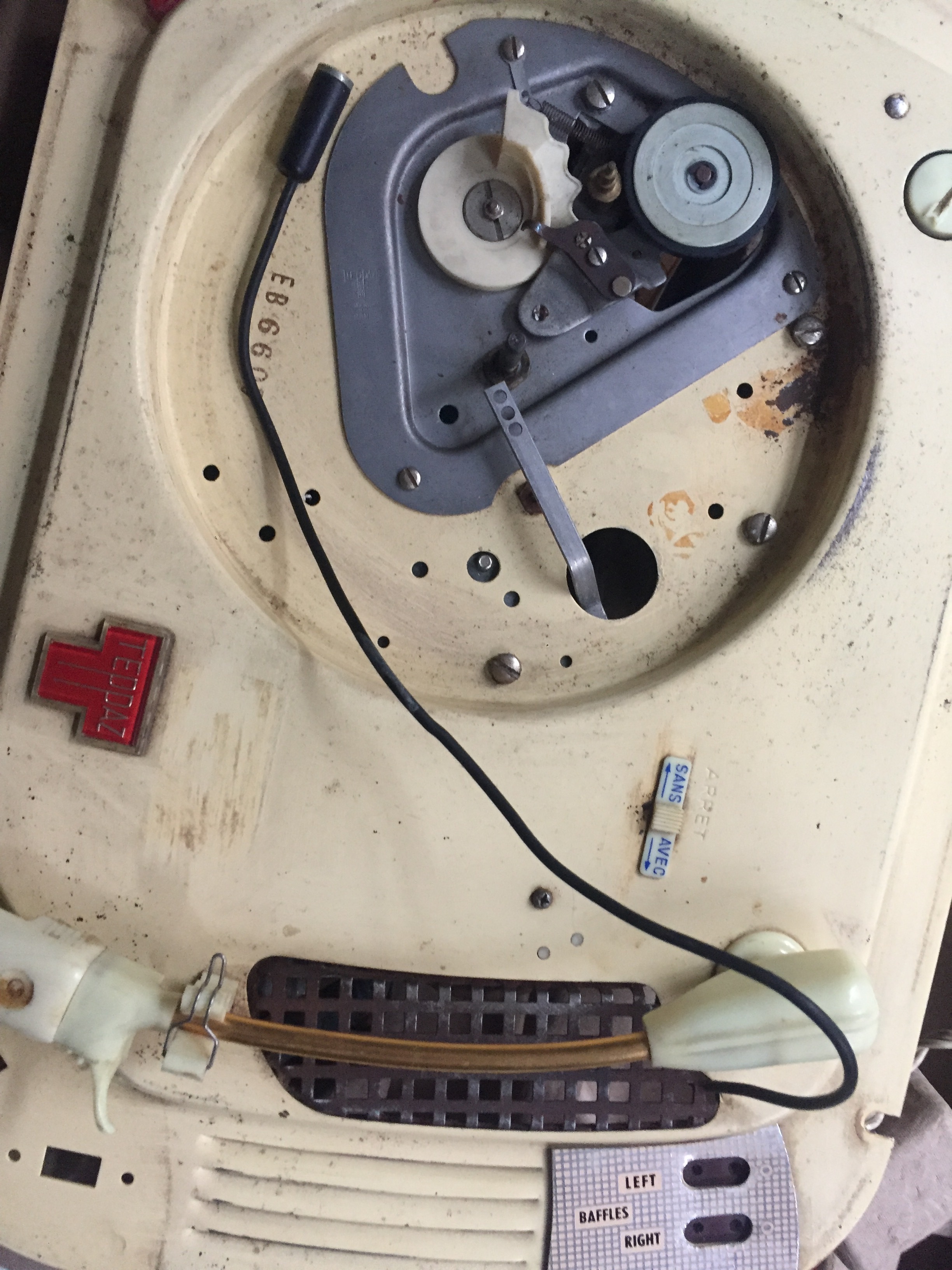

I also want to know what the SANS / AVEC switch was used for. Does anyone have a operating manual that I can print?
That is a great story you are sharing here. If i can help i will. If you have challenges with French and translations let me know.
means auto-stop: YES/NO (Avec:Yes, Sans:No)
this means that the machine will eventually stop at the end of disk played or not

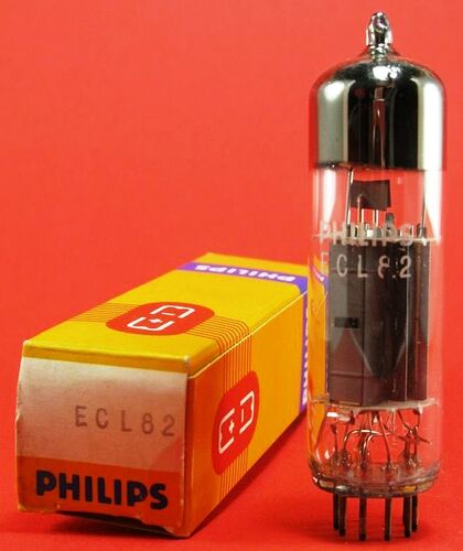

Also can you give us a proper picture of the inscription on the ECL82 lamp inside?

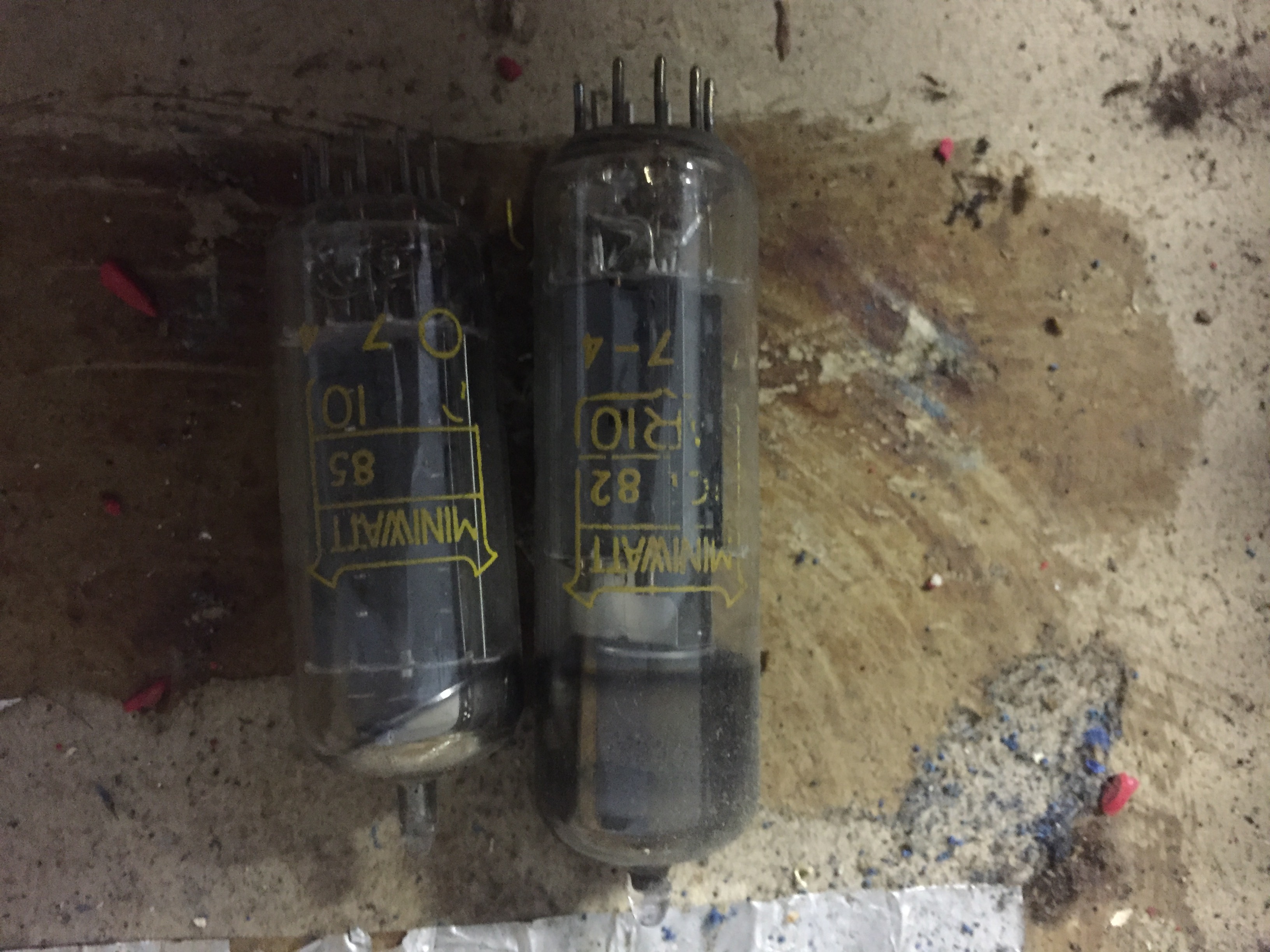

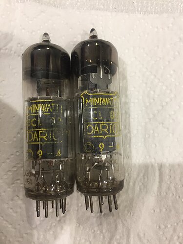

Hi All,
herewith the pictures of the two valves, i have taken them out for safe keeping while i restore

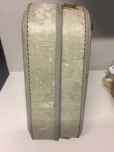

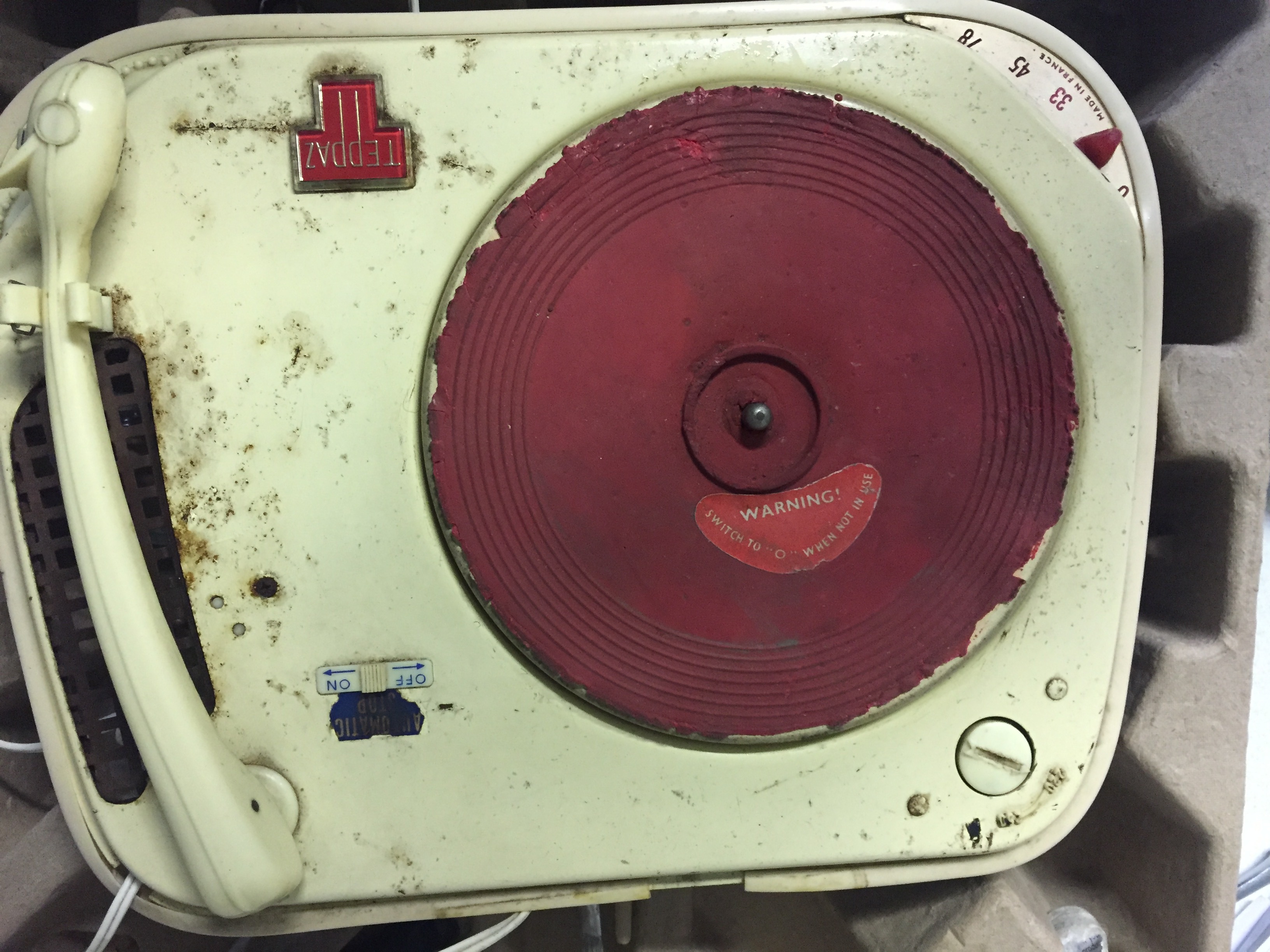

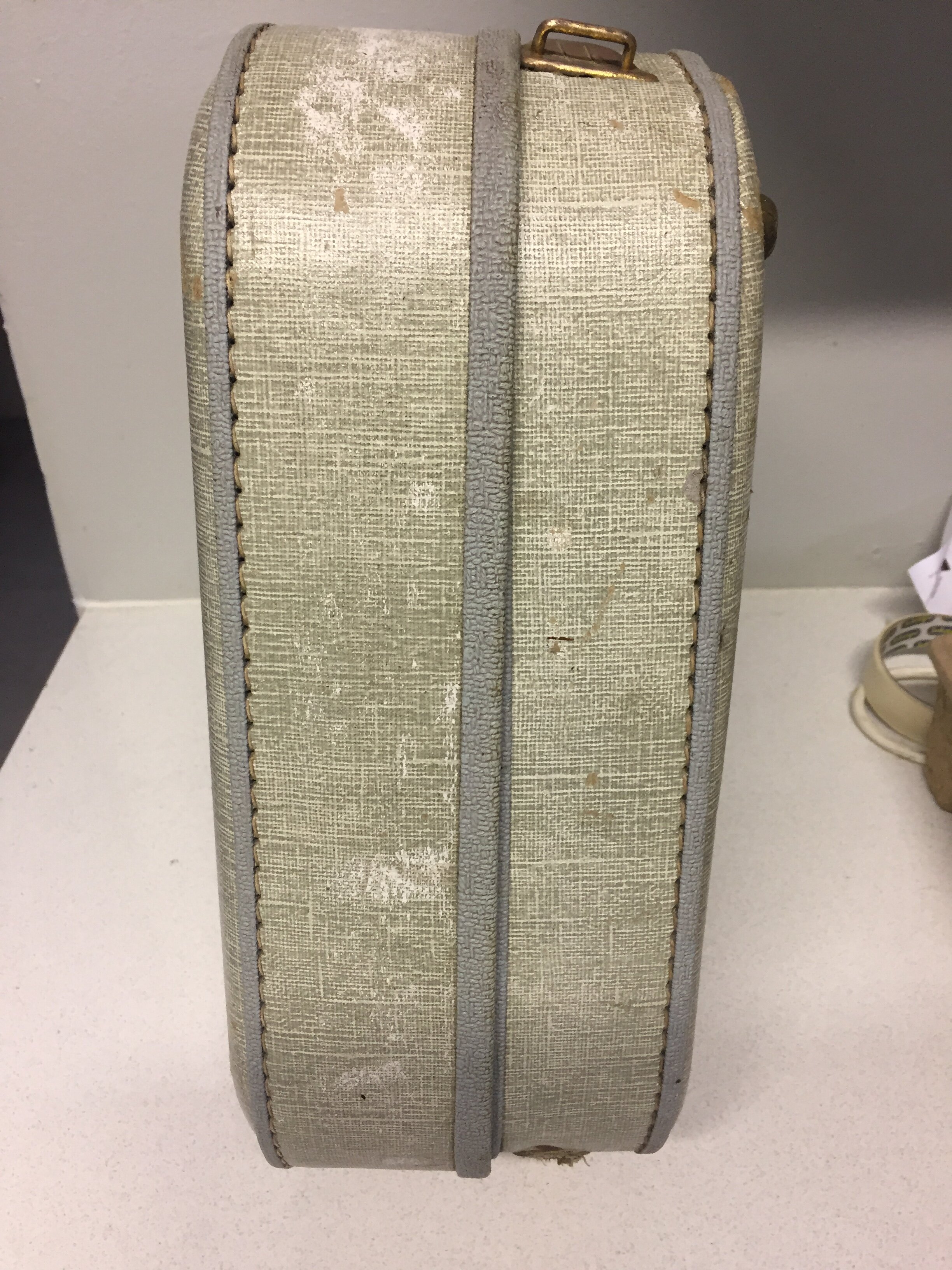

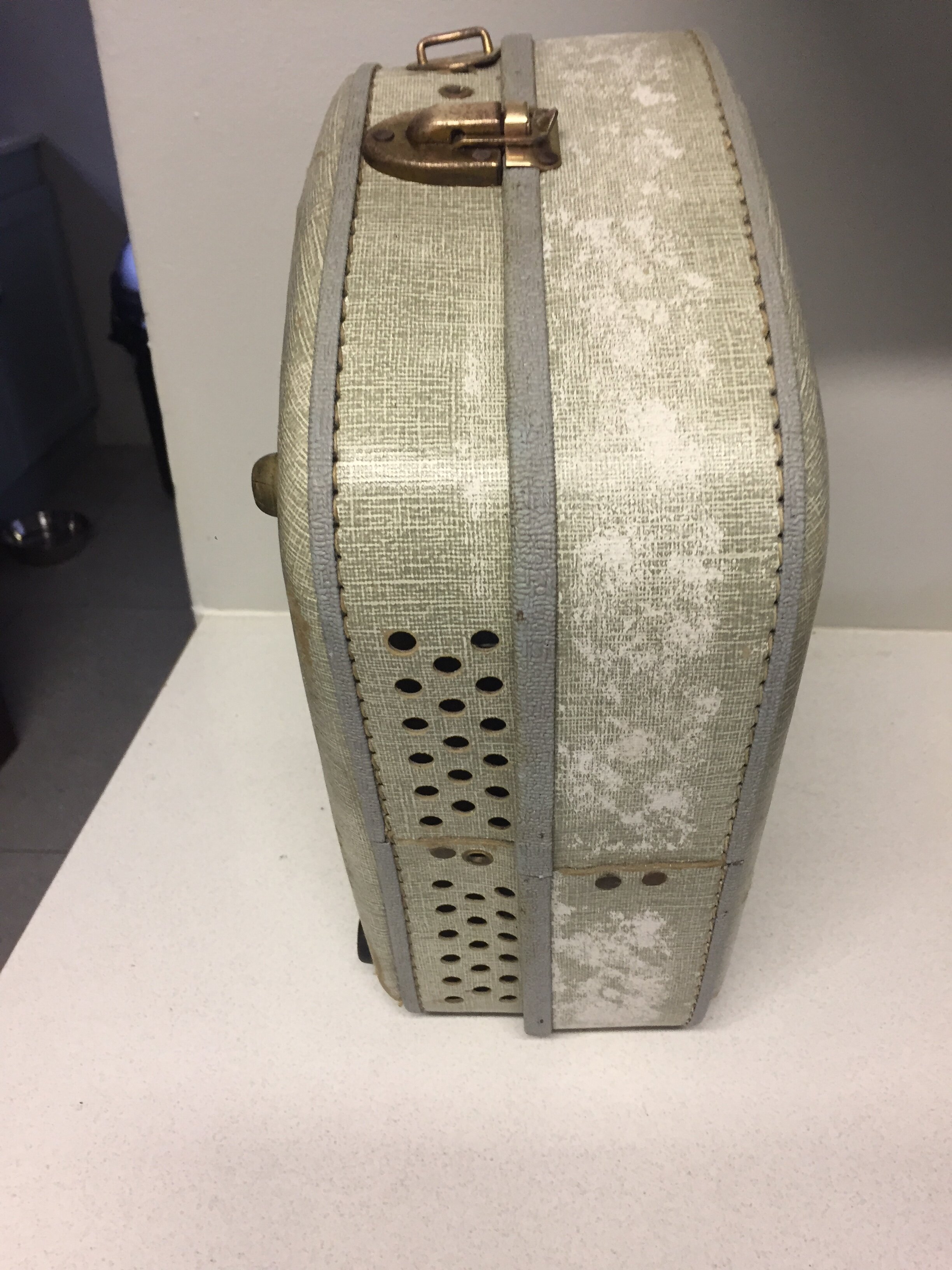

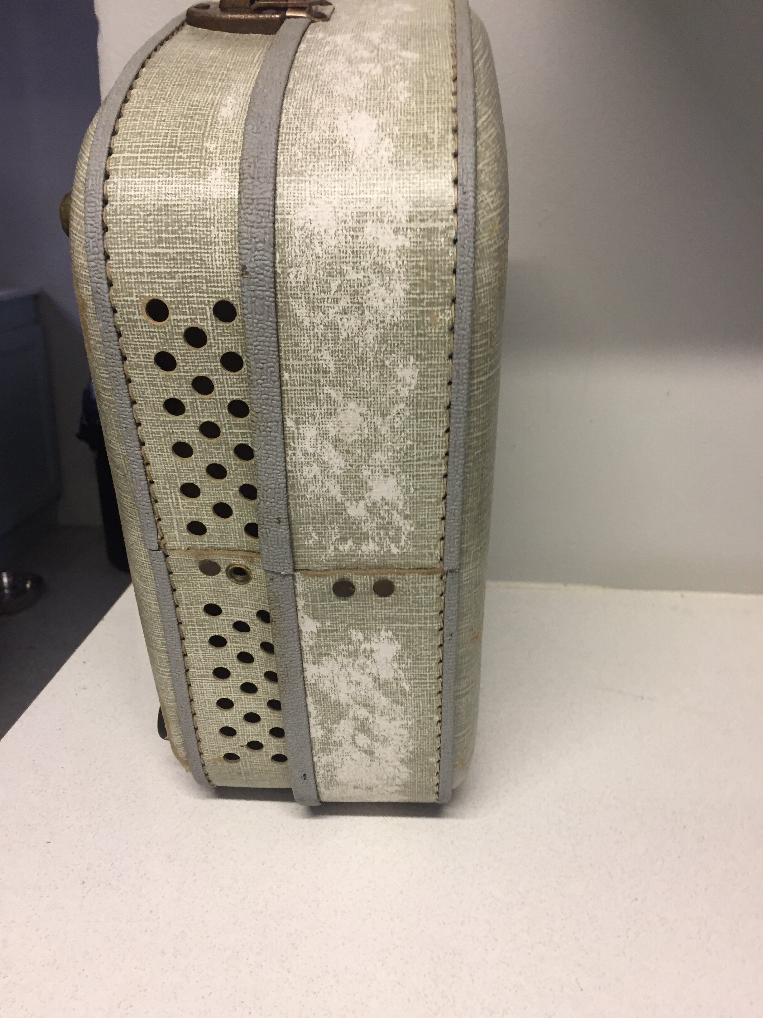

Well I am still in the process of restoring the one Teppaz in my previous posts, and came a cross another one which is much older. See attached pictures.
I have a question for the forum, what do you guys do to restore the print on the casing? As you can see this one has some scuff marks.

I think you have to make a new painting on the metal plate
dismantle a possible , sand paper
primer painting
and color painting

for the case it is worn impossible to repar it
Hi Radiolo,
Thank you for your response, I was thinking of recovering with a nice retro cloth… But maybe i should keep it original

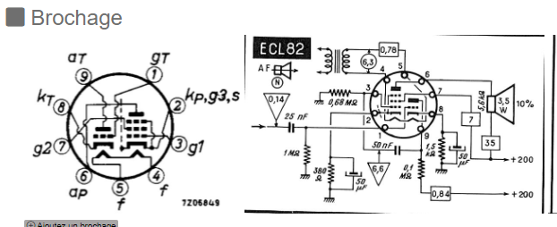

with a multimeter only the filament can be check

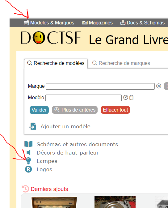

for the pinout you find it in this section with teh reference of the tube ECL82

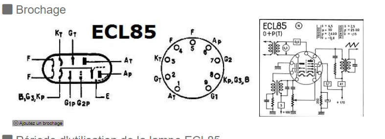

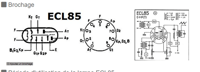

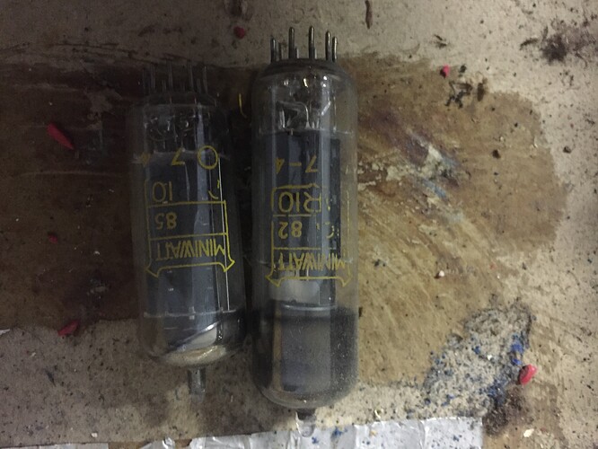

Trust all is well with you. Would it be normal for the unit i posted yesterday to have two different Lamps - 85 & 82. Then I am not sure if they were ACL or ECL as the writing has rubbed off. Can you advise? Much appreciated
Regards - from Cape Town
Hein
ACL never exist
ECL85 and ECL82 it is the same functions :triode and power penthode but not the same pin out
so you can not exchange the two tube
il the two tubes a used on a stereo amplifier one is a mistake and has replaced by someone who dit not know electronics…
probably the good reference is ECL82
