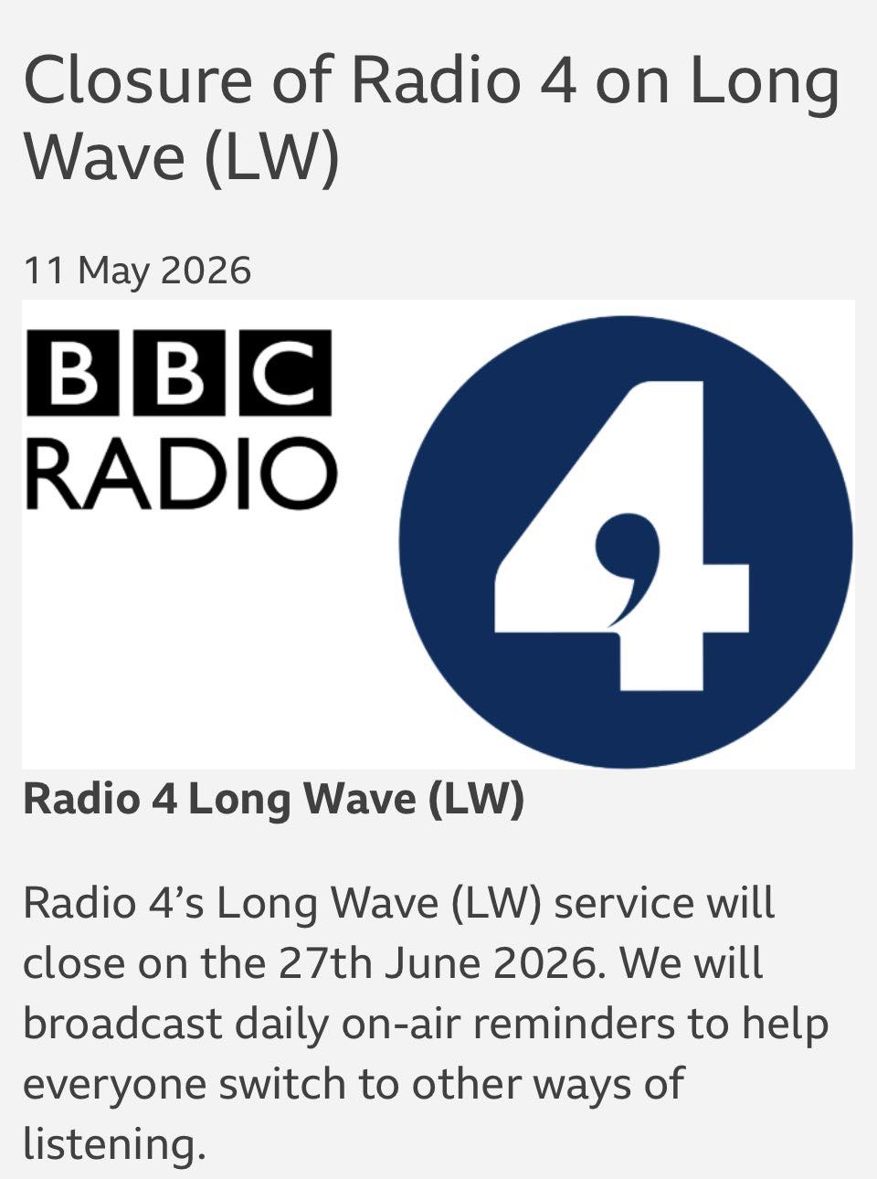

La BBC confirme l’arrêt de ses émetteurs ondes longues… mais n’annonce pas de date :

Radio 4 Long Wave (LW)
Radio 4’s Long Wave (LW) service will close on the 27th June 2026. We will broadcast daily on-air reminders to help everyone switch to other ways of listening.
Why the LW service is closing
The company that owns and operates the LW broadcast equipment has confirmed that the system is reaching the end of its life. As LW is an older broadcasting technology, recent years have seen a decline in listener numbers, with the majority now opting for FM and DAB digital platforms. Given these factors, investing in upgrading the LW equipment is not considered a cost-effective solution for licence fee-funded services. You can verify the services available at your location by visiting our transmitter checker.
Supporting listeners through the change
To facilitate this transition away from LW and ensure it is as smooth as possible, we will be producing comprehensive guidance on alternative ways to listen through our website and helpline, outlining alternative methods for accessing BBC Radio 4 content. Visit our new factsheet for advice on how to keep listening, How to Continue Listening to Radio 4 after the Closure of LW.
Information for users of RTS electricity meters
Some older electricity meters use a system called the Radio Teleswitching Service (RTS) that is carried within the LW signal. This service is run by the energy industry, not the BBC. If you need advice about replacing or upgrading an RTS meter, please contact your energy supplier or the relevant energy regulator. The BBC does not manage or control the RTS system.
This information is also accessible through a recorded telephone message at 0203 977 1480.

La BBC va abandonner la diffusion de BBC 4 sur grandes ondes à 198 khz depuis le célèbre émetteur de Droitwich.
La date est fixée au 27 juin 2026, mais aucune heure précise n’est donnée. Les grandes ondes seront bien vides…

Un fin annoncée en anglais il y a une semaine sur le forum :
Quoi de neuf sur les Grandes Ondes? - Salon - Forum Retrotechnique
Pour une fois, au moins ce n’est pas un 31 décembre…
Patrick.
Ni même le 30 juin ! :wink:
Mais c’est un samedi …
sur le lien on peut lire :
ce qui rend cette fermeture encore plus intéressante etant donné qu’il existe toujours un paquet de compteurs RTS en activité comme on peut lire sur la page wikipédia du système.
By the end of May 2025, the number of radio teleswitch meters left in service had reduced to 314,395.
